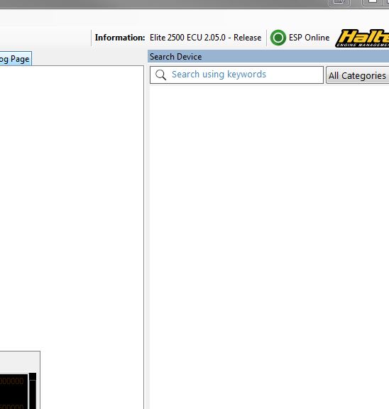

One of the things that Haltech got right (which I have never seen another company do) is that they will let you run any version of their software that you want to. You can run the oldest firmware that they have or the brand new stuff. And this got me thinking. The 2.05.0 firmware was the closest that they had to traction control perfection but you couldn't turn it off without a laptop.

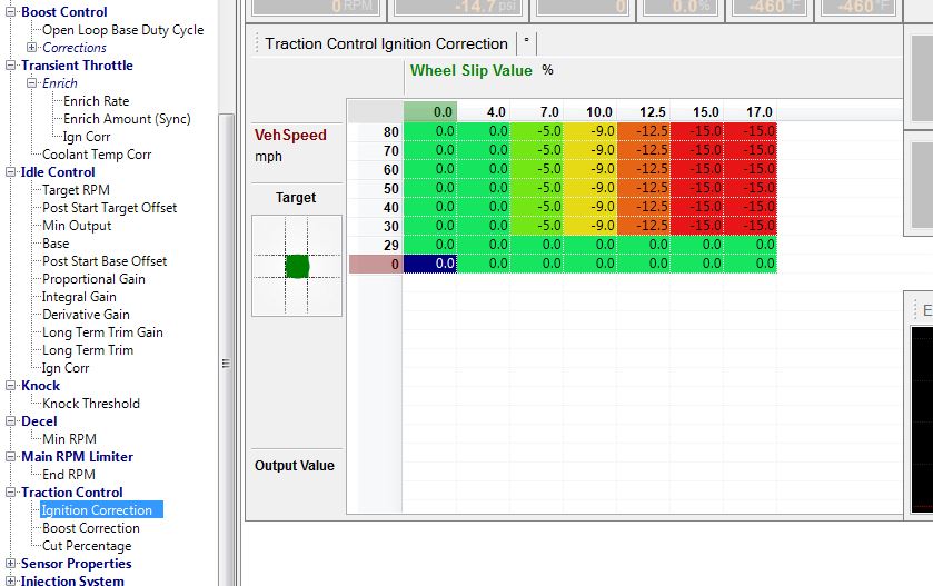

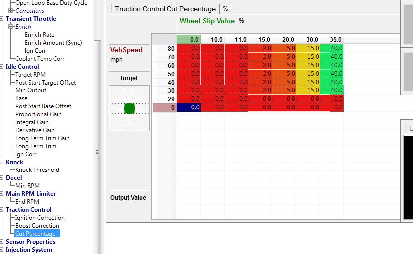

The traction strategy that I went with was very straightforward as well. Ignition retard to take out small amounts of wheel spin smoothly and safely...then cylinder kill for the heavy lifting. I also used cylinder kill for areas that I wanted to make sure that no large amount of slip occurred.
This is what the tables I used look like:
The reason that low speed was taken out of these maps is because the wheel speed sensors aren't accurate enough down low. If you want to use this for sub 25MPH driving you will prob need to switch over to digital senors.

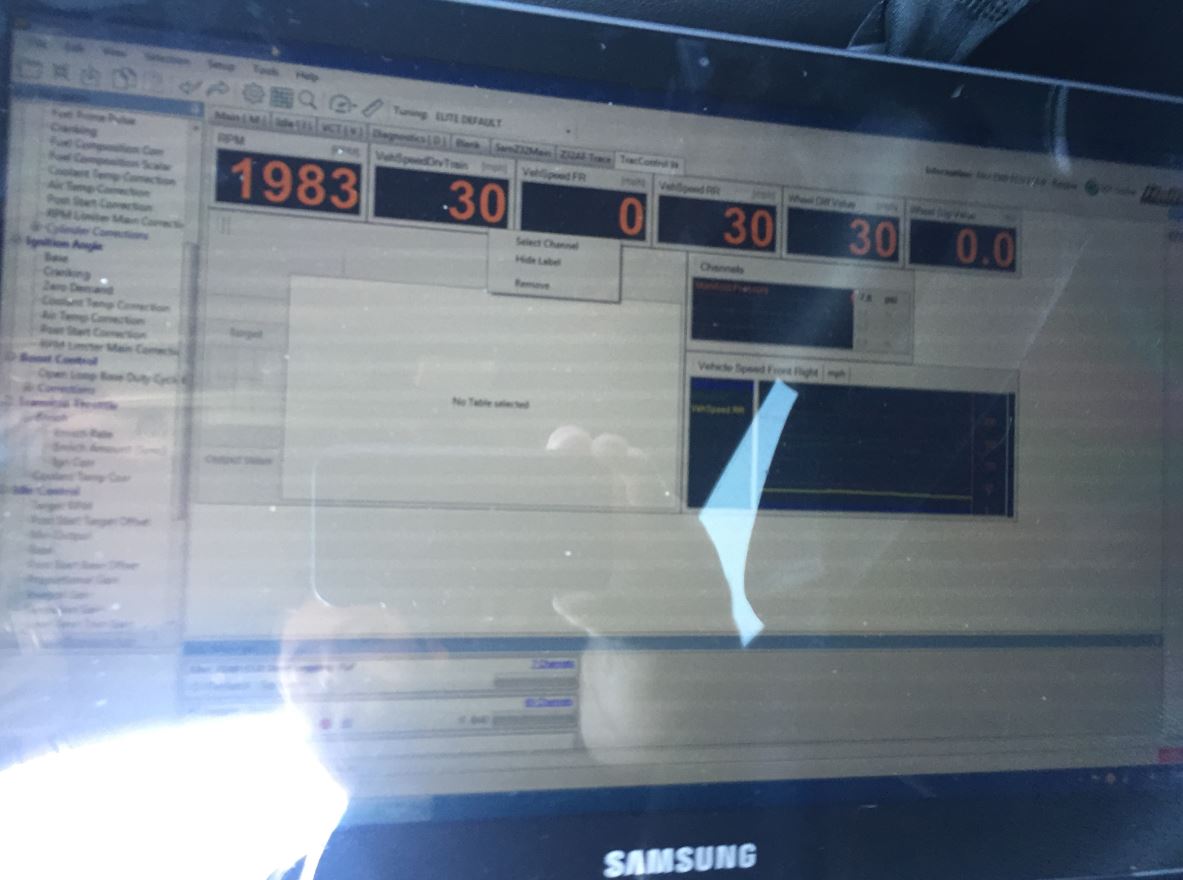

and proof the switch works....notice FR is 0 and slip is also 0 so nothing is being triggered :)
